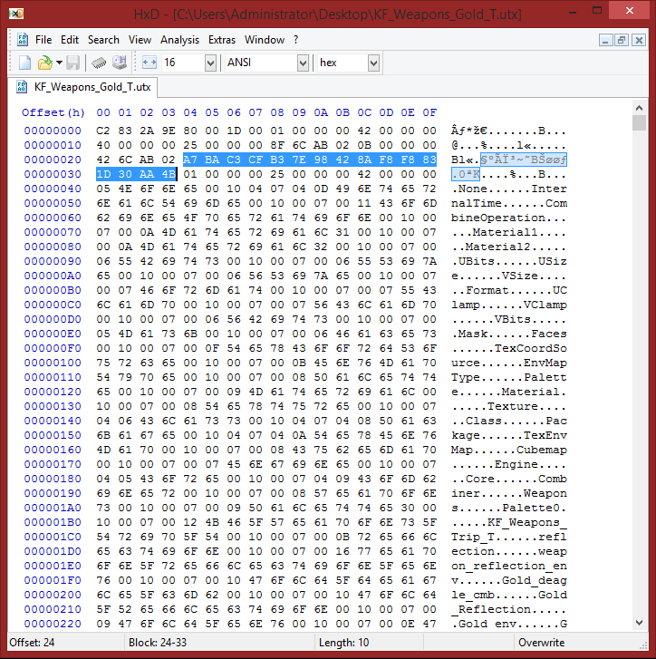

HI all! I need to make something very simpl with many files! I need to get "specific bytes" from one file, and replace them to the same address on an another file:
So that the specified value on the 2nd file will become same as on the 1st file.
Can you tell me how I can do this easily with SlickEdit or any other hex editor software? Thank you in advance!
